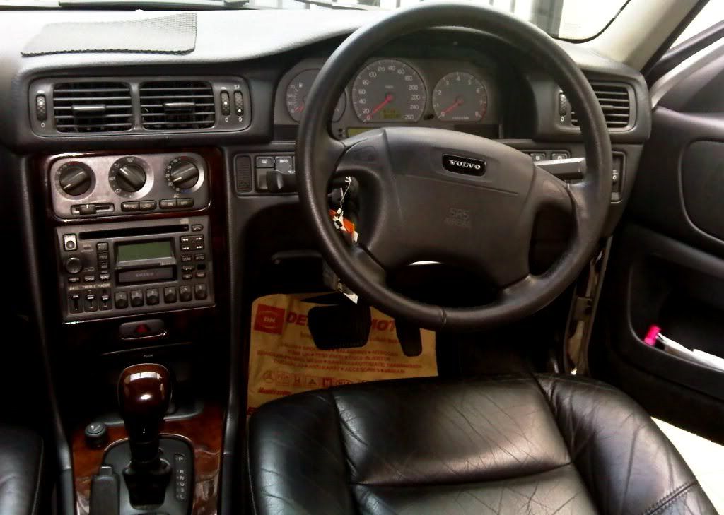

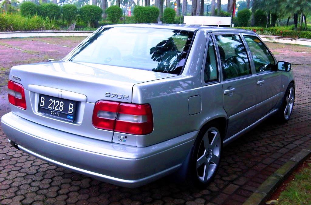

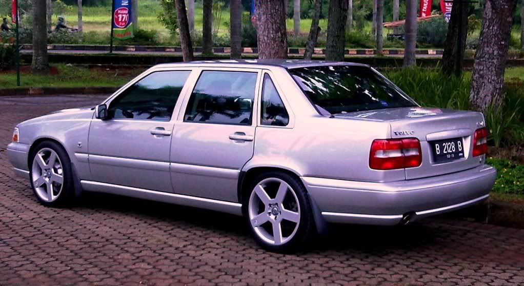

    Bos… mau ikutan nongolin Volvo nubi dikit yah ...
    Review stge I utk Volvo S70 T5 taun 98 warna silver. (standard 240hp)
    Udah kurang lebih 2th setengah nubi pake nih mobil.. dpt dr tgn pertama yg cukup terawat, lumayan kondisinya.
    Karna mobil sudah tua n nubi suka sedikit speed , abis bayar ni mobil, nubi lakuin restorarsi dikit, check n perbaikan berharap utk dapetin Stage 0 lagi:
    -Eng. condition lumayan halus dapetnya
    -Ganti rotor; rotor caps; check cables plugs n ganti plugs.
    -ganti timing belt; serpentine belt; tension belt.
    -kuras tangki bensin; check fuel line, ganti fuel pump std
    -kuras/ circulate oil matic dgn 17 liter n ganti 8,5 ltr oil matic pake mobil 3309
    -kuras intercooler
    -check compression n cylinder leak down test
    - carbon clean n kalibrasi injector
    -clean 02 sensor
    - kuras air radiator, ganti water pump
    -ganti thermostart 87” ipd
    -Ganti aki
    - ganti all engine mounting bawah std n ganti power transmision mount
    - ganti upper mount firewall n mounting stabilizer atas polyurethane ipd
    -oil engine flush n ganti oli mobil 1 sae 5-50 fullsyntetic
    -ada bunyi pump power steering “ngung” dikit saat belok, dr ambil neh mobil, jadi nubi replaced kebetulan dapet baru.
    -ganti slang pwr steering in n out
    -check turbo n ganti oil seal turbo ipd
    Restorasi kaki2 n bawah nubi lakuin penggantian dikit n check juga deh biar aman…
    -ganti link stabilizer n mounting
    -ganti balljoint check as roda n ganti boots as roda
    -ganti bushing 2 depan belakang.
    -ganti shocks bilstein touring types n lowering kits H&R spec S70/850
    -ganti upper spring seat depan- belakang std
    Berhubung brakes standard t5 agak terasa ngeglosor saat di speed atas n transmisi matic, so nubi kasih penambahan dikit:
    - ganti Big brakes depan AP racing caliper 4piston n disc AP Racing 330mm spec S70/850 n pad 600”F
    -ganti SS braided fuel line AP Racing
    circulates brakes oil 3ltr dot4
    -ganti disc blakang brembo std n diberi lubang ventilasi n ganti pad std
    -pasang strutbar bawah depan n belakang merk ultra racing spec s70/850
    Interior: (almost nga ada yg diganti) std s70 T5 ajaa
    -turbo timer pivot
    - ganti stir std baru
    -tambahin karpet mangkok s70
    -interval wiper intermiten ipd
    -door lock R ipd
    -audio n cd changer std s70, masih dolby
    -ganti kaca film Vcool clear semua kaca
    - ganti lampu cabin led
    -pasang mmd 2pintu depan
    Eksterior : (minor changed)
    -cat original, pernah di sol Fr bemper bawah foglamp lecet2. N poles salon mobil
    -ganti diamond cut VST head lamps; corner lamp n sidelamp
    -hid 6000k headlamp n foglamp
    - custom grill egg crates
    -pasang Rr. muds flaps
    -ganti velg TITAN R18 dapet type ROSSO nya second, mayan mulus
    -ganti ban R18 Continental sport contact 2
    Engine: ( naikin ke stage 1 dikit)
    -rubah / Reverse n besarin pipa intercooler SS 2,5inch plus silicone hose HKS
    - air filter HKS 200
    -pasang BOV HKS ssqv
    - coil msd blaster
    -custom air filter box SS n wrap w/ billion anti heat
    - Air intake vacuum2 lines n vacuum line turbo HKS
    - cable busi 9,9mm Lucas
    -pasang volt stabilizer pivot
    -sbg pendukung, seperated matic cooler dr radiator, pake kondensor sendiri.
    Begitu kira2 project s70 t5 nubi.. yg kira2 tinggal 15% lagi ke stage II, nubi anggap selesai.
    Review test di jln tol Cuma sekali-kalinya sampe 215km/h dgn cepat n mudah dicapai, throttle nya masih banyak sisa tapi nubi Lepas gas nya karna nga brani… jiper sendiri dgn kodisi jalan .
    Setelah yg nubi lakuin diatas, Alhamdulillah kondisi mobil sehat2 slalu,
    Cuma ganti oli mesin interval pakai merk n type yg sama dgn sebelumnya til now on.
    Segitu aja share nubi mhon maaf kalo tdk berkenan..
    Salaam sukses slalu...
